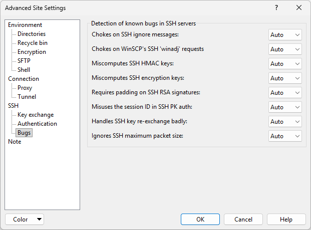

The Bugs Page (Advanced Site Settings dialog)
The Bugs page on the Advanced Site Settings dialog allows you to configure the bugs WinSCP should expect to see in the SSH server.
To reveal this page you need to select SCP or SFTP file protocol on Login dialog.
Not all SSH servers work properly. Various existing servers have bugs in them, which can make it impossible for a client to talk to them unless it knows about the bug and works around it.
Since most servers announce their software version number at the beginning of the SSH connection, WinSCP will attempt to detect which bugs it can expect to see in the server and automatically enable workarounds. However, sometimes it will make mistakes; if the server has been deliberately configured to conceal its version number, or if the server is a version which WinSCP’s bug database does not know about, then WinSCP will not know what bugs to expect.
Each bug can be configured in three states. With Off WinSCP will assume that the server does not have the bug. With On WinSCP will assume that the server does have the bug. With Auto (default) WinSCP will try to guess whether or not the server has the bug.
