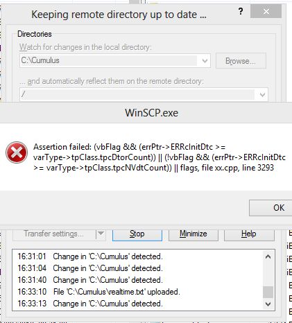

Latest failure, instead of 2 x Invalid Pointer Operation, got one of those with a...
Access violation at address 74F21EF3 in module "KERNELBASE.dll" Read of address 03550000
...over the top

Having received debug version, run it with problem occurring and having sent debug output...
Have again had problem with Invalid Pointer Operation messages plus never ending...
Assertion failed:FTerminal-> OnReadDirectory==DoReadDirectory, file Components\UnixDirView.cpp,line573
...messages.
Have sent you email with location of new debug log file.
