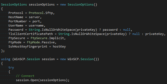

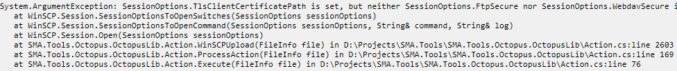

Hi, I am finally getting around to trying to use this code and am getting the following error...
The code I am using to create the session options is....
I can't see what is wrong here. The TLS Client Certificate is a PPK file, the host key is copied from WinSCP
Any suggestions?
Any suggestions?
Site Admin -
Re: Argument Exception
The .ppk file is not FTP TLS client client certificate, it's SSH/SFTP private key file. Use
SessionOptions.SshPrivateKeyPath.
