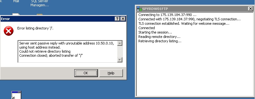

Hi, I got an error mentioning this error when I connected to the hostname.
Protocol is FTPS Explicit in GUI mode.
Server sent passive reply with unroutable address 10.50.0.10, using host address instead.
Could not retrieve directory listing
Connection closed; aborted transfer of "/"
Any idea how to resolve this?

Log for WinSCP
-Refer To Attachment for Screenshot
Description: WinSCP Error.

@Innersphere: Please attach a full log file showing the problem (using the latest version of WinSCP).
Also attach a corresponding log file from FileZilla.
Hi, I receive a similar error when I try to connect the WinSCP to a Windows 2012 R2 IIS FTP server

. 2016-12-09 12:13:36.213 Server sent passive reply with unroutable address %%%.%%%.%%%.%%%, using host address instead.
> 2016-12-09 12:13:36.213 LIST -a
. 2016-12-09 12:13:36.213 Connecting to ###.###.###.###:58700 ...
< 2016-12-09 12:13:36.229 150 Opening ASCII mode data connection.
. 2016-12-09 12:13:45.495 Timeout detected. (data connection)
. 2016-12-09 12:13:45.495 Could not retrieve directory listing
* 2016-12-09 12:13:45.667 (EFatal) **Lost connection.**
* 2016-12-09 12:13:45.667 Server sent passive reply with unroutable address %%%.%%%.%%%.%%%, using host address instead.
* 2016-12-09 12:13:45.667 Timeout detected. (data connection)
* 2016-12-09 12:13:45.667 Could not retrieve directory listing
* 2016-12-09 12:13:45.667 Error listing directory '/'.

Makc666
50
MSK-RU
Re: Server sent passive reply with unroutable address
@keny2020j: You need to setup your IIS FTP server to correctly handle Passive mode.
In "FTP Firewall Support" section setup "Data Channel Port Range".
Also you can setup "External IP Address of Firewall" there.
Also for each site you can set its own "External IP Address of Firewall" also in "FTP Firewall Support" section but in that site's section.
https://learn.microsoft.com/en-us/previous-versions/windows/it-pro/windows-server-2012-r2-and-2012/hh831817(v=ws.11)
