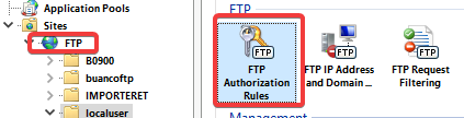

Problem seems to found:
There was double rules on 'FTP Authorization Rules' on both level FTP (shown here) and the same rules was on the localuser folder with holds each users isolated folder (shown here)
Apparently that's a no-go. Does anyone have any experience with this behavior?
