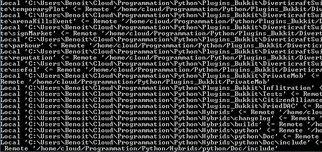

It seems perfect to me, but when I start the script : ok, It check all differences :
Then, It say :
But, I have :

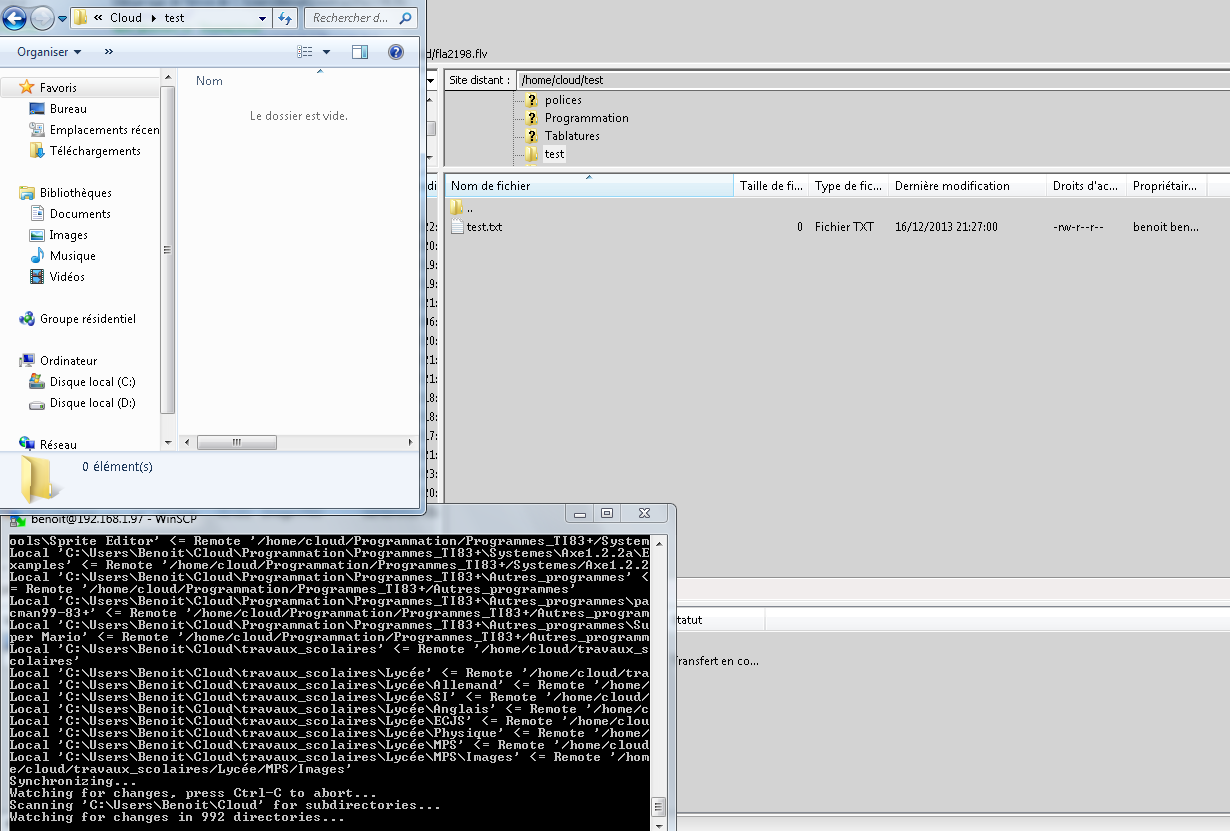

And, If I modify the local folder like that, It doesn't work more (I update FTP client before taking screenshot) :

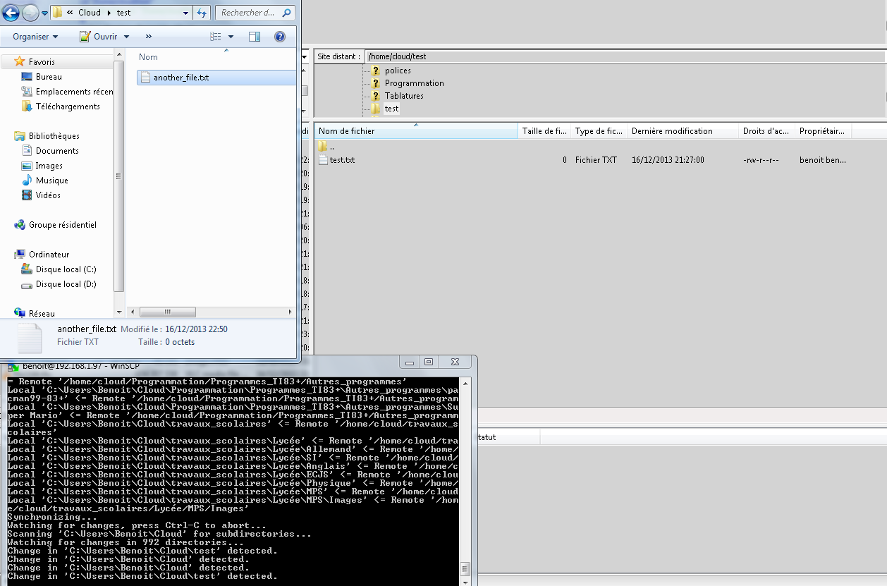

At least, It detect that I modify the folder... but doesn't upload.

The reason is that you have Existing files only option enabled (in GUI):
. 2013-12-19 19:15:38.624 Synchronizing local directory 'C:\Users\Benoit\Cloud\test\' with remote directory '/home/cloud/test/', params = 0xBF (Delete, NoConfirmation, ExistingOnly, NoRecurse, UseCache, DelayProgress, SubDirs)
I suppose that you run 5.5 with different configuration (INI file).
The best is if you isolate your script run from GUI configuration. See:
https://winscp.net/eng/docs/scripting#configuration
