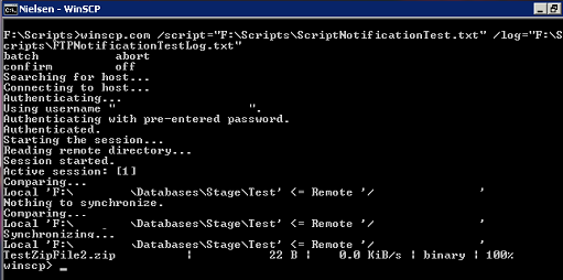

Hi there, I am looking to get a little help with my WinSCP synchronize batch script. First, I am looking to have the script output a notification, whether the script has successfully synchronized files or returned an errorlevel 1. As you can see in the screenshot provided below, I am presently not receiving a success or unsuccessful message at the end of my script.
You are missing exit command at the end of your script, so it never terminates.
