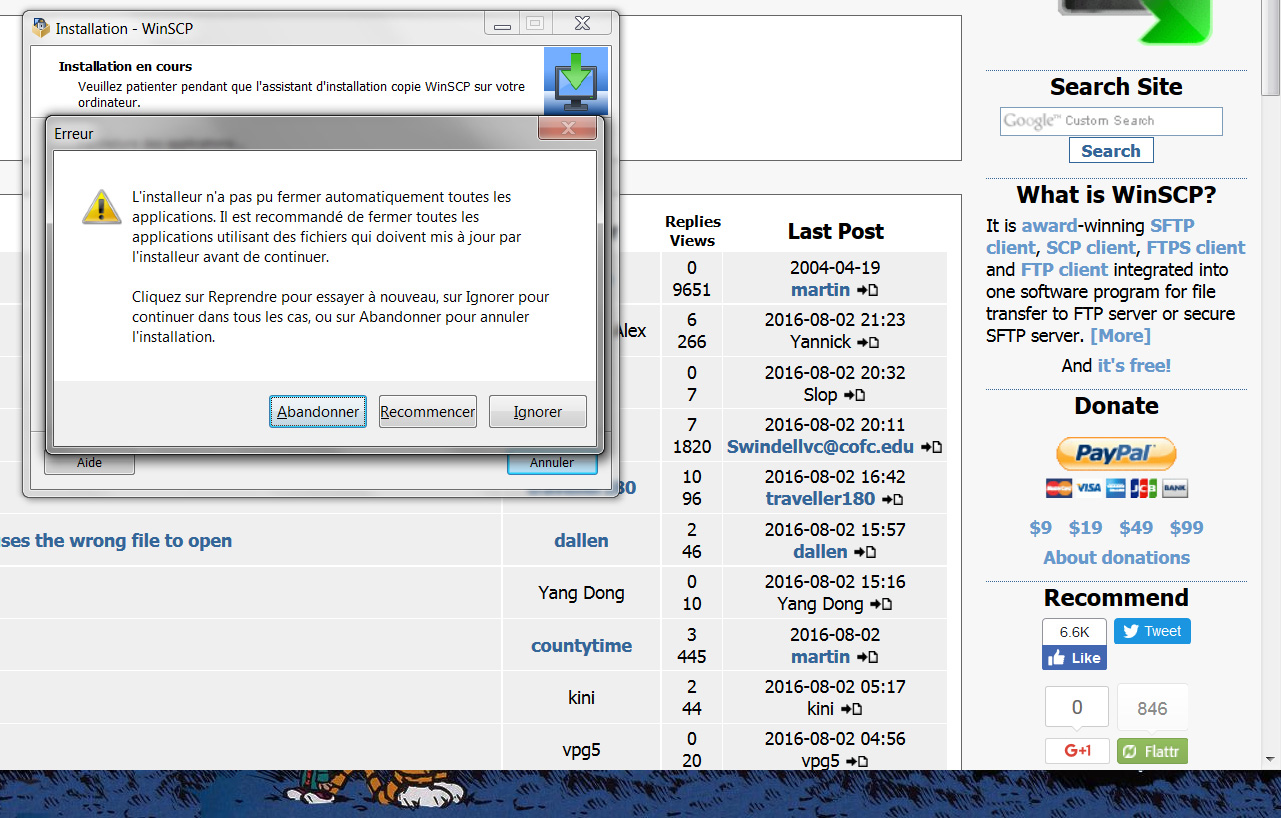

Yes.
I downgraded to my previous version (good to be a backup maniac), and, yes, I can reproduce the bug.
Launched version 5.8.3, clicked to check for upgrades, was prompted of an update, clicked Update, that closed WinScp and launched the 5.9 installer (windows asking to allow or not, etc), after which the explorer died, the program didn't respond for like 20 seconds when alt-tabbing to other applications and back to the installer, until at last the attached pic.
In the attached pic, you see the last step, in which I clicked to abandon.
The bottom of the pic ought to have been the windows bar, and instead we see a bit of background.
