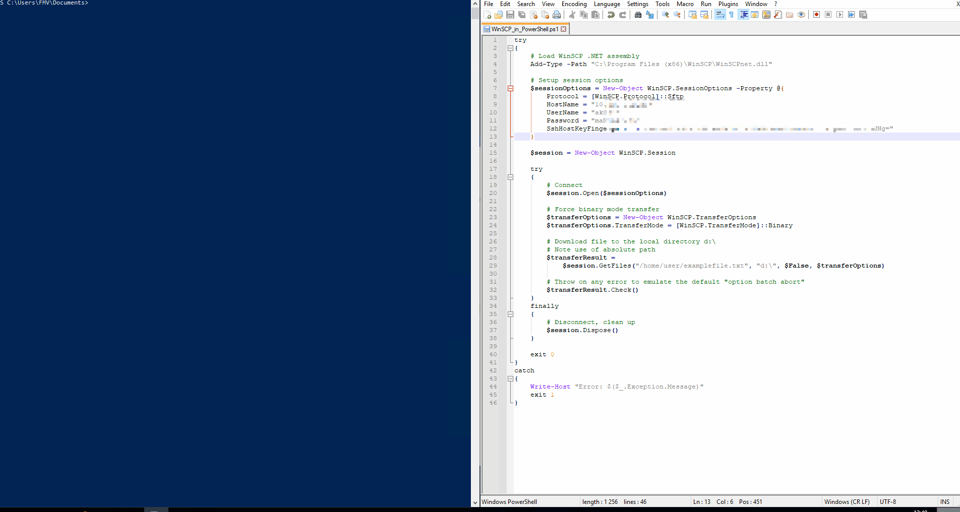

I have a version of the code I'm using:
Add-Type -Path "C:\Program Files (x86)\WinSCP\WinSCPnet.dll"
$sessionOptions = New-Object WinSCP.SessionOptions -Property @{
    Protocol = [WinSCP.Protocol]::Sftp
    HostName = "1*.***.***.*0"
    UserName = "a*****1"
    Password = "m*********9"
    SshHostKeyFingerprint = "ssh-ed25519 255 eeDKU******************************UNg="
$session.SessionLogPath = "C:\Users\FMV\Documents\logging.log"
try
    # Connect
    # Your code
    # From VM to Laptop
    $session.GetFiles("full***********.csv", "C:\Users\fmv\Downloads\" )
finally
    $session.Dispose()
And in attach the logs.
I was able to test this code on a VM that I created especially for this issue. Everything works.
VM TEST:
– WinSCP Version 5.19.2
– rsa2
– Command: working
– Powershell Script: working
PROD:
– WinSCP Version 5.17.10
– ssh-ed25519
– Command: working
– PowerShell Script: fails
Can the hotkey be the problem?

I have download the portable version of WinSCP and I pointed the Add-Type -Path to the \netstandard2.0\WinSCPnet.dll and \net40\WinSCPnet.dll. Still failing for both :(
The error in PowerShell is always the same:
Exception calling "Open" with "1" argument(s): "Connection has been unexpectedly closed. Server sent command exit status 0.
Using username "a***1".
Access denied.
Authentication failed."
At C:\Users\FMV\Documents\test.ps1:18 char:5
+     $session.Open($sessionOptions)
    + CategoryInfo          : NotSpecified: (:) [], MethodInvocationException
    + FullyQualifiedErrorId : SessionRemoteException
But the exact same code works on my Test VM environment.
Where can be the problem?
