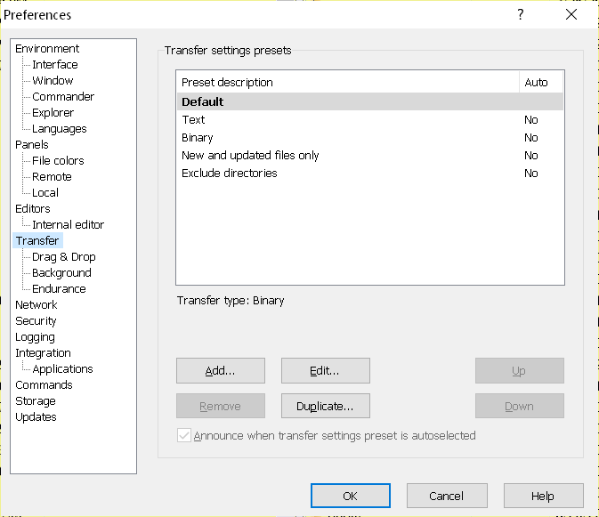

For future reference:
Calculate Size can be found under menu Options/Preferences and then click Transfer and look to the Common Options-area.

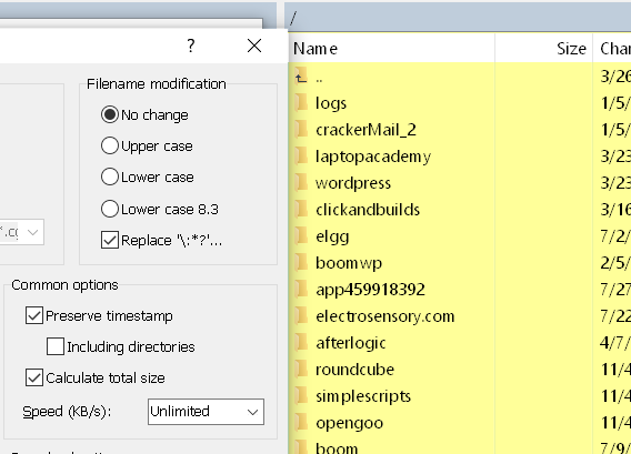

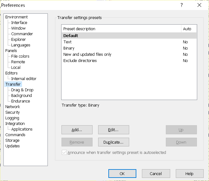

@adrian_vg: Thank you, that is MOUNTAINS more useful than "Please read documentation" in these search results.
However, by version 5.5.1 there was an extra step, to find and click "edit" once in the "Transfer" settings box. Then I see these "Common Options".

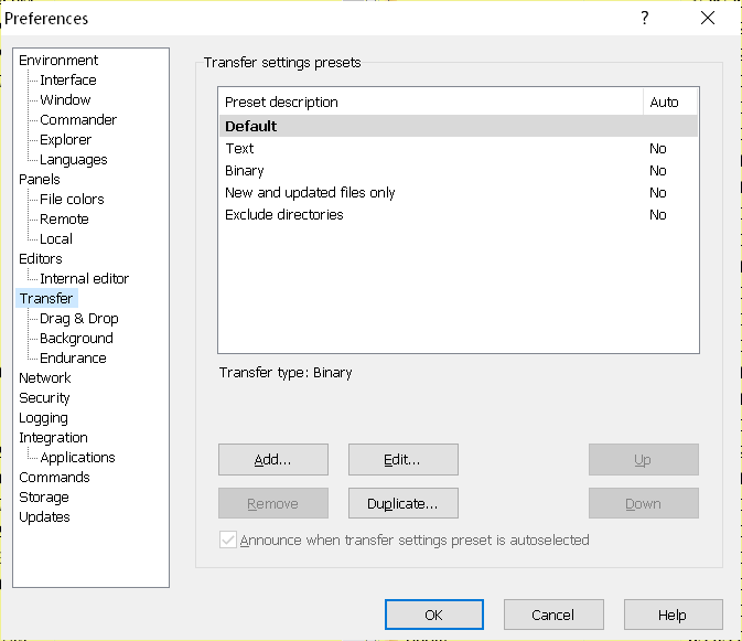

Has this feature been removed? I don't see it.
modabasi@...
Same problem here
I've disabled "Calculate total size" through Options, does not calculate but transfers files one by one. If I make the transfers in the background, it starts calculating again.
